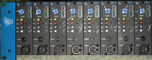

A tastefully populated rack of 8 API 512c modules. Classic micamps like these, originally designed to be fitted into a modular console, are often re-issued for rackmount use.

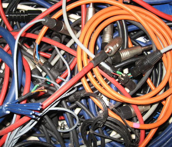

Old leads and tarnished connectors can cripple a perfectly good sound source, and make it impossible for a micamp to extract any quality at the other end.

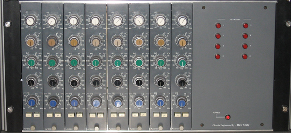

A rack of original Neve 33122 modules. First released in the 70s, these micamps (and countless variations on the theme) are still very popular for their warm sound.

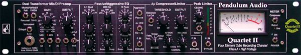

Pendulum Audio Quartet II: this micamp and channel strip is the engineer’s holy grail. The micamp offers a choice of 2 transformers on the input or none at all, and an increasingly popular choice of input impedances.

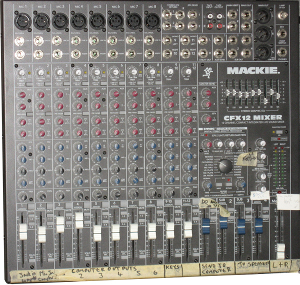

Remember: cheap components can also mean cheap design. Micamps found on popular mixing consoles or budget channel strips are pretty basic and use standard integrated circuits, which barely deliver the goods at their best.
A cheap analogue console can’t compete with purpose-built micamps.

    We’re calling Mackies “cheap” now. I’ll give you it’s no Allen & Heath, but really, “cheap”?
    I could understand if you had a pic of some busted up Behringer or Alesis, but Mackies are pretty decent as mid range mixers go.
