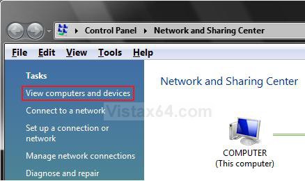

1. Through the Control Panel
A) Open the Control Panel (Classic view).​
B) Click on the Network and Sharing Center icon.​
C) Go to step 3.​
2. Through the Network System Tray Icon
A) Right click on the taskbar Network system tray icon.​
B) Click on Network and Sharing Center.​
3. Click on View computers and devices. (See screenshot below)​
A) Go to step 5.​

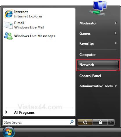

4. Through the Start Menu Network Button
A) Open the Start Menu.​
B) Click on the Network button. (See screenshot below)​
5. After a moment, you should see a list of computers and devices that your computer found on the network. (See screenshot below step 6)​

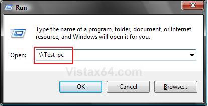

7. Through the Run Command Window
A) Open Run.​
B) Type in the: \\ComputerName or \\Ip Address of the computer on the network. (See screenshot below)​
NOTE: For example, this computer name: \\Test-pc
C) Click on OK.​

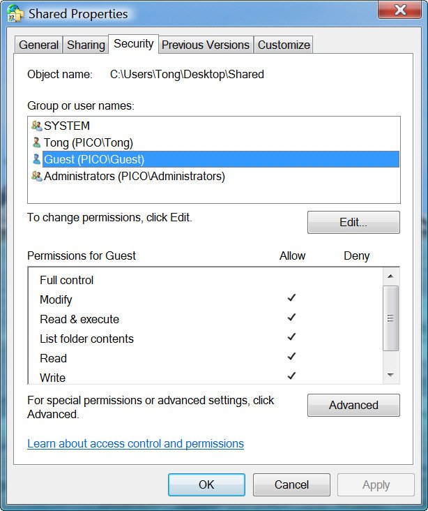

If you got error "Access is denided." when access shared folder on XP or VISTA or 7, there are some places to checkup.
1. HKEY_LOCAL_MACHINE\SYSTEM\CurrentControlSet\Control\Lsa
restrictanonymous must equal to 0. Otherwise you will can't get shared name(s) on \\machine.
2. Enable Guest account on shared machine. Otherwise you will can't access shared folder.
3. Add or setup Guest permissions to that shared folder. Otherwise you will can't list/read/write/delete file(s).
