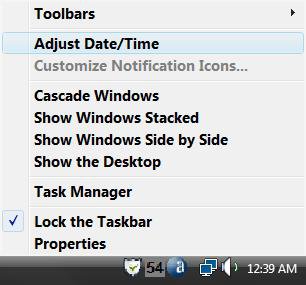

This will show you how to Enable or Disable the context (right click) menu for the Start menu and button, Taskbar buttons, and Clock for all users on the computer. By default, these context menus are enabled.
Note   Note
Disabling these context menus does not prevent users from using other methods to issue the commands that appear on these context menus. It just hides and prevents access to the context menus.
EXAMPLE: Start Menu and Button, Taskbar and Taskbar Buttons, and Clock Context Menus

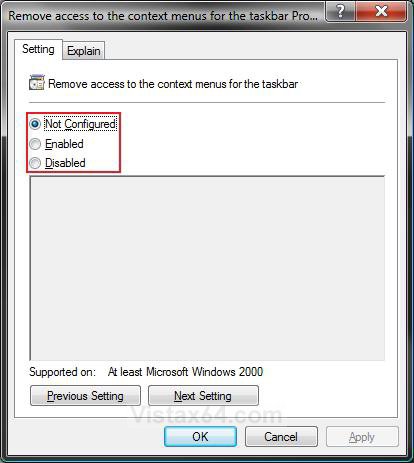

2. In the left pane, click on User Configuration, Administrative Templates, and Start Menu and Taskbar. (See screenshot below)​
3. In the right pane, right click on Remove access to the context menus for the taskbar and click on Properties. (See screenshot above)​
4. To Enable Taskbar Context Menus
A) Select (dot) Disabled or Not Configured, then click on OK. (See screenshot below step 5A)​
B) Go to step 6.​
5. To Disable Taskbar Context Menus
A) Selec (dot) Enabled and click OK.​
6. Close the Local Group Policy Editor window. Your done.​

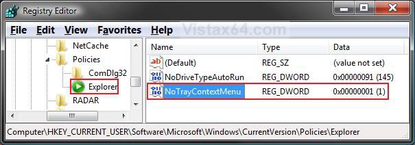

4. In regedit, go to: (See screenshot below)​
HKEY_CURRENT_USER\Software\Microsoft\Windows\CurrentVersion\Policies\Explorer
A) In the right pane, right click on a empty area and click on New and DWORD (32-bit) Value. (See screenshot above)​
B) Type NoTrayContextMenu and press Enter.​
C) Right click on NoTrayContextMenu and click on Modify. (See screenshot below)​
D) Type 1 and click on OK. (See screenshot below)​
E) The registry will now look like this. (See screenshot below)​
F) Go to step 7.​

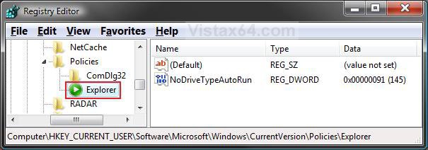

6. To Enable Taskbar Context Menus
A) In the right pane, right click on NoTrayContextMenu and click on Delete. (See screenshot above)​
B) Click on Yes to confirm deletion.​
