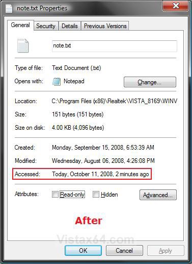

EXAMPLE: Last Access Updating Before (disabled) and After (enabled)
NOTE:
To see the last accessed time for a file, right click on the file and click on Properties. It will be listed as Accessed in the General tab. You will notice the Accessed time will be more current now when this is enabled (after).

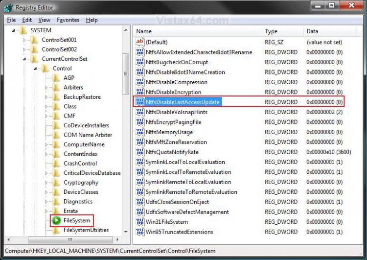

4. In regedit, go to: (See screenshot below)​
HKEY_LOCAL_MACHINE\SYSTEM\CurrentControlSet\Control\FileSystem

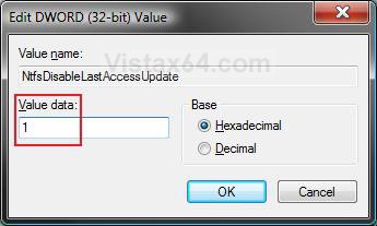

5. To Enable Last Access Updating
A) In the right pane, right click on NtfsDisableLastAccessUpdate and click on Modify. (See screenshot above)​
B) Type 0 (number zero) and click on OK. (See screenshot below)​
C) The registry will now look like this. (See sceenshot below)​
D) Go to step 7.​
6. To Disable Last Access Updating
B) Type 1 and click on OK. (See screenshot below)​
C) The registry will now look like the screenshot under step 4.​
